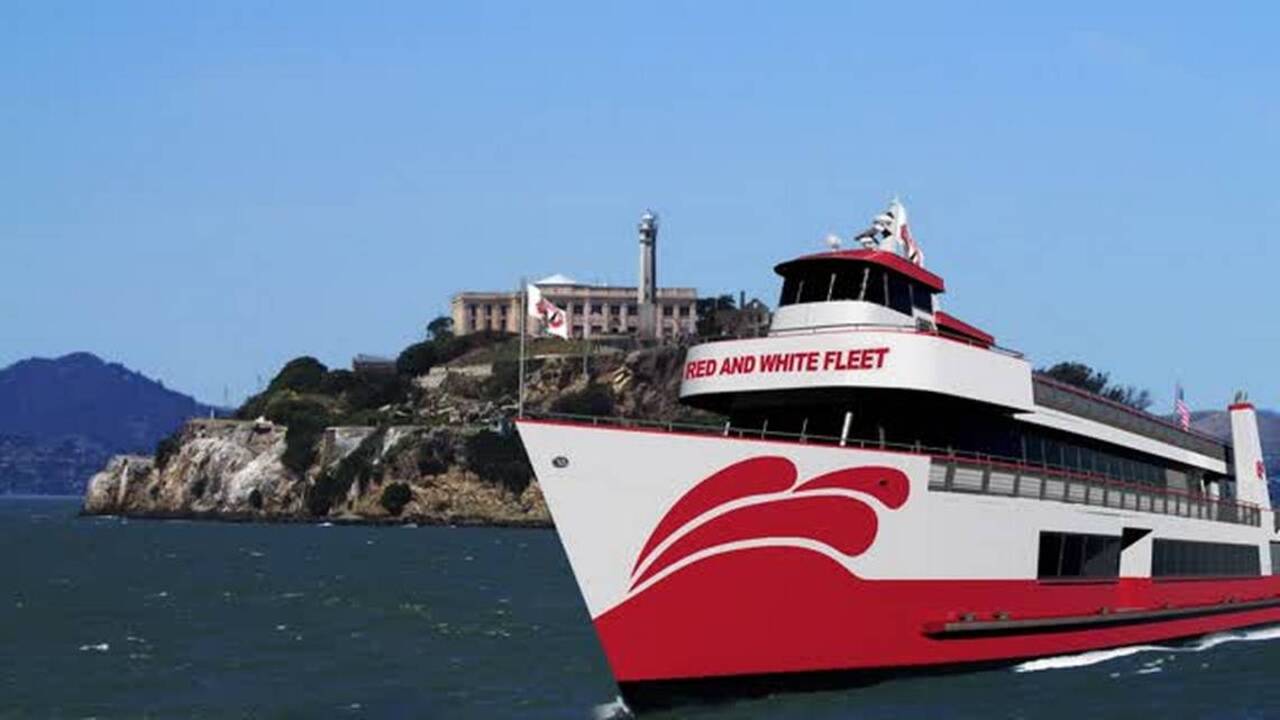

    A local builder here is building a hybrid ship for a San Francisco based tour company. Cant wait to see how it works out.
    The M/V Enhydra, a 600-passenger hybrid electric boat is being built at All American Marine's new facility in Bellingham, Wednesday, Aug. 9, 2017. The boat builder says the 128-foot vessel will be the largest lithium-ion hybrid electric passenger
