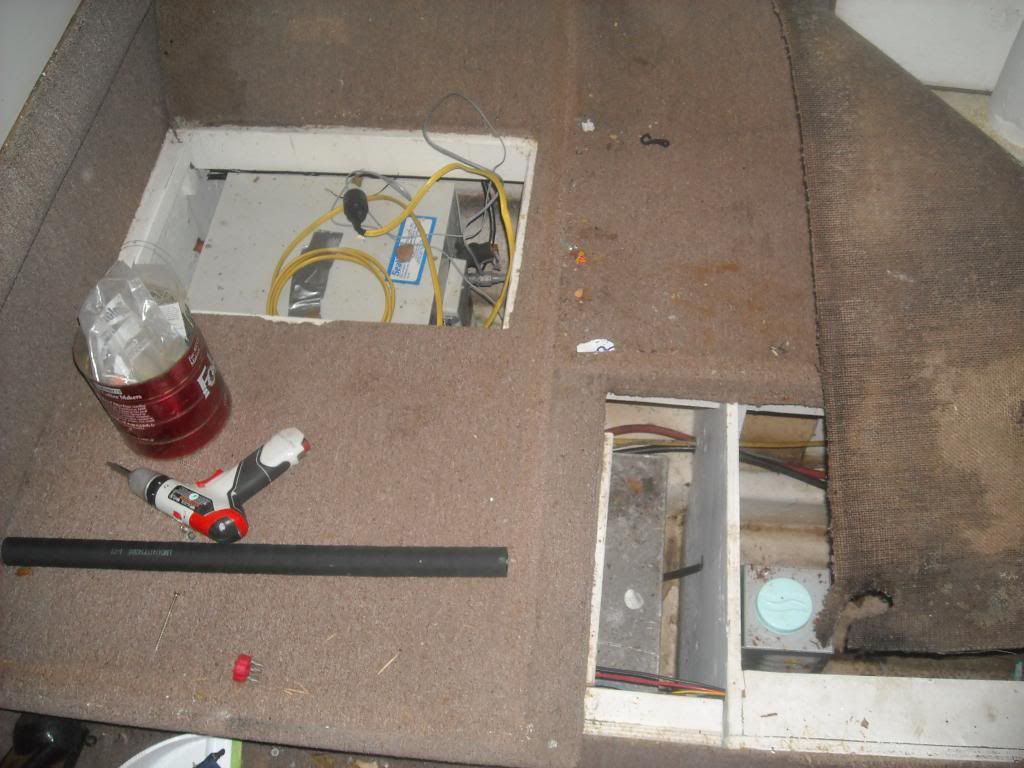

    A week ago I found fuel in the bulge (about 15 gallon), had a friend presser test the tank... and there is a leak... so started pulling ever thing out last night and will try to get the carpet and floor out today....
    My water tank has not been useable since we got the boat years ago and now sounds like a good time to try and clean it or put a new one in....
    Any one that has done this..... How did you do the carpet, looks to have a staple about ever 1/16" along one side, a friend said to get a gasket scraper but have not went to look at one
    Also thinking of just putting a roll in bed liner on the mean floor and maybe a wood laminate under the table area... what do you think...?
    I will be trying to keep my photo bucket updated as I work on it and post here as I am going along.

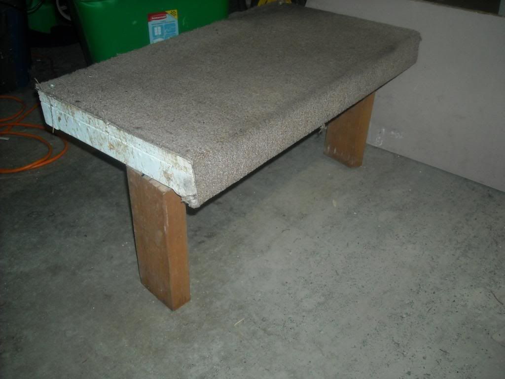

    Old Step i will be rebiulding... broke in the middle of last season.. this was a quick fix

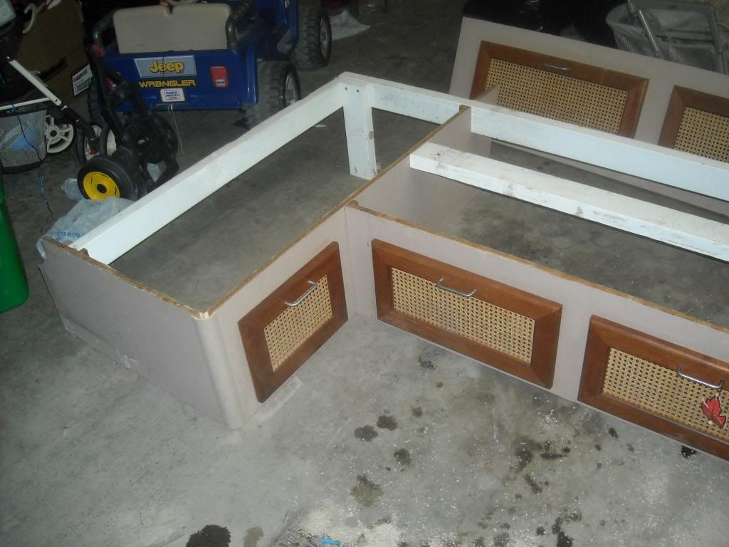

    below are just a few more
    well the tank is out and is going to the welder (A friend i work with) tomorrow
    Here is the tank hold... needs to be cleaned, today...

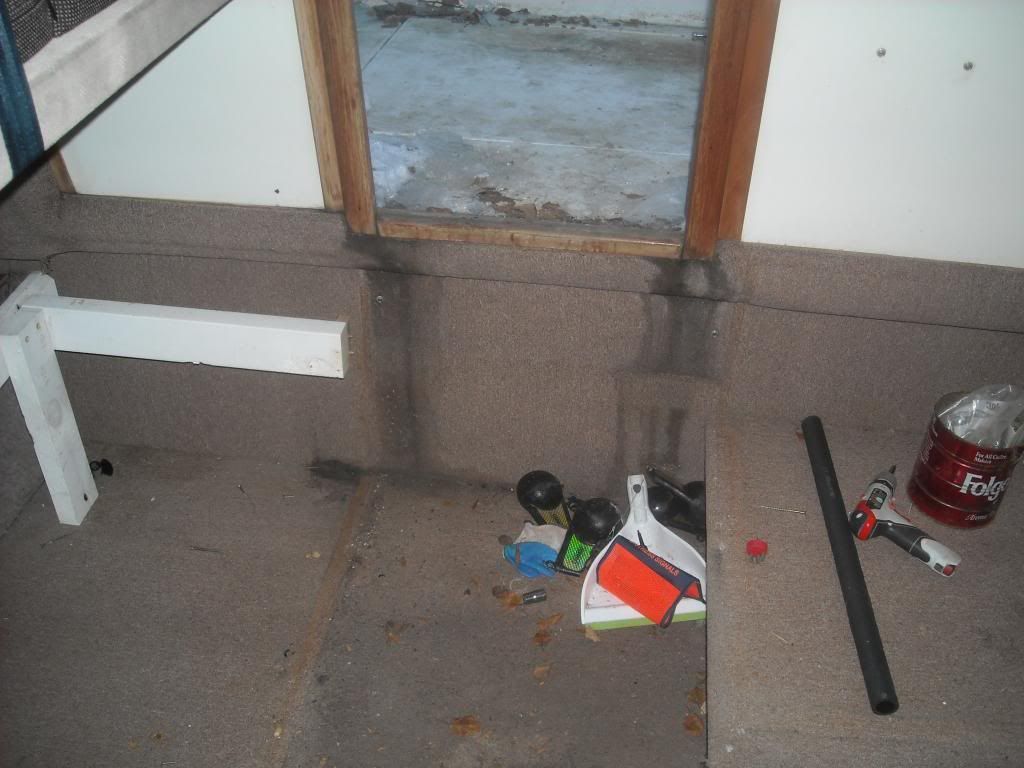

    today i will be cleaning it and pulling the water tank to try and clean it
    1. After welding, you think I should seal the tank with bed liner or a flexsteel spray to help stop the pitting
    2. Clean the bilge to get all the fuel out.. What should I use.. I was think warm water and dish soap....
    3. I am think of putting a thin piece of plywood with Berliner on it for the new floor what do you thin
