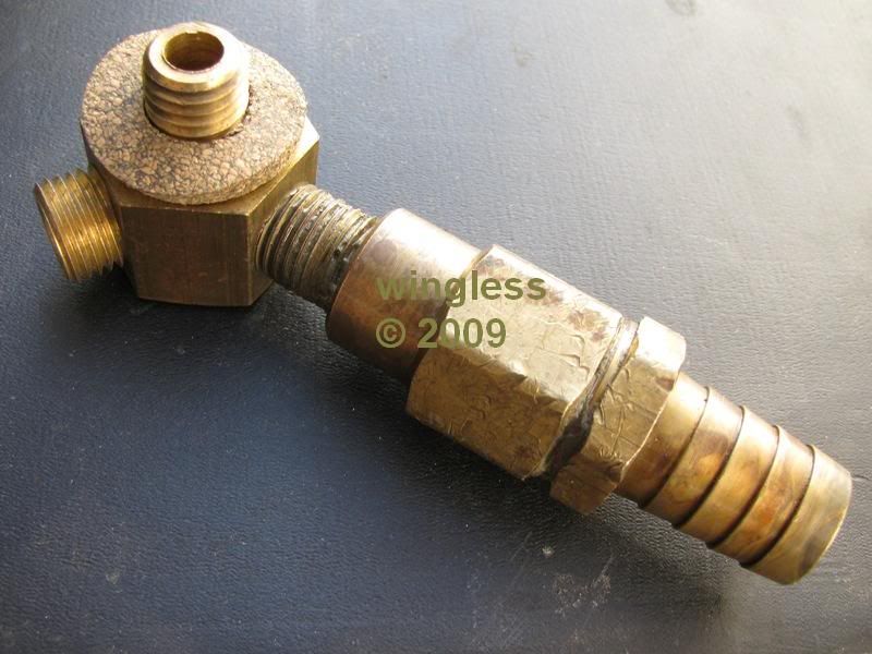

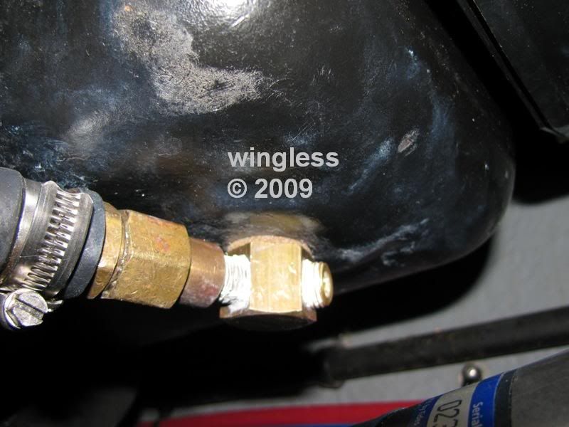

              On mine I plumbed up both engines, both transmissions and the gen w/ 5/8" ID hose to a manifold and high volume pump. I drain my 8 quarts in ten seconds, for a rapid oil / filter change.

                Replacing the drain plug w/ a banjo bolt and a hose is a nice addition while access is available.
                Here are some images of the banjo bolt / hose barb for sucking 8 quarts of oil in ten seconds from the bottom of the drain pain.
                  Scary. Both the cork gasket and the molestation on those brass fittings with pliers or loose crescent wrench?
