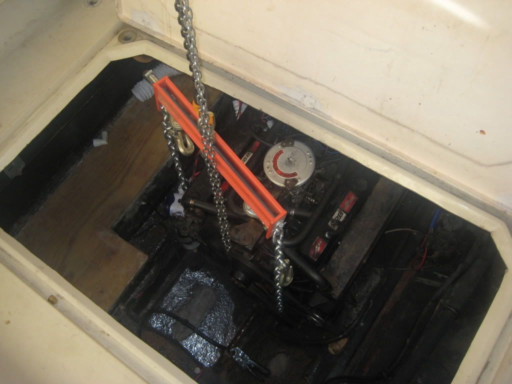

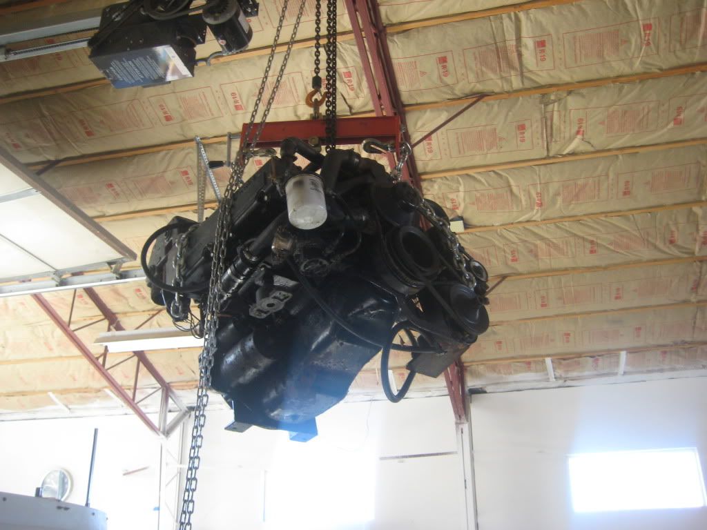

                    Attached files [img]/media/kunena/attachments/vb/651860=24438-CIMG0007.jpg[/img]
                      kalsobrook wrote:
                      $60 bucks for lumber $40 bucks for 1/2 ton chain hoist.......works great. Entire rig has caster wheels to move it around on my concrete driveway.
                      Oil leaks in bilge: loose oil filter or defective/missing oil seal ring in filter. Loose galley plug near oil filter bypass. Leaking valve covers. Front/rear main seals. Timing chain cover. Leaking oil pan gasket. Cracked block.
                      You are a braver man than me! I was able to "borrow" a friends shop. I thought long and hard about the home made gantry crane route, but ultimatley decided against it.
