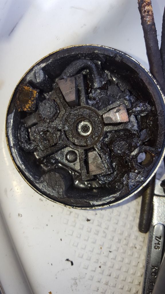

    i took the starter apart to find 1 busted brush and a hole bunch of burnt plastic inside. it still works(after cleaning) but its corroded and i dont think i can get just the brush vs 50 bucks for a new one...
    gonna get a new starter
    i should be ordering a new starter tomorrow depending on my paycheck after all bills. i will order a new regulator/rectifier if i have to.
