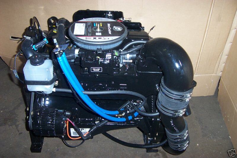

          I'm guessing that you mean the "quick-disconnect drain hoses", clearly visible in blue on the picture here:
          Our 175 has them too but I've never used them, a good flush using the hose and muffs on the outdrive is all we've ever done but the climate in Brisbane never gets cold enough to freeze so even in mid winter the block will be OK with some water still in it (as long as its not salty) and the "too cold for boating" season only lasts a few weeks anyway.
          Here is an online manual that covers this, have a look at section 6-A, page 6A-8
            That is exactly what I am lookin at. So reading in the manual all the "dipstick "is for is to hold the lines down. Thanks for the link!
