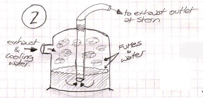

          With the water lock style muffler, the diesel exhaust must over-come the water lift!
          With the jet ski muffler, the diesel exhaust will not need to over-come as much water lift..... at least not in the same fashion!
          Water Lock muffler principle;
          Food for thought!
