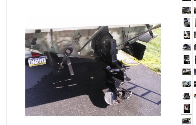

            12x12 look like:

              I did a little research on the web this morning and it appears that the 2452 came from the factory with 12" x 9" Trim Tabs
              They are indeed undersized, and replacing them with 12" x 12" with the 3" drop fins like the ones in Go Aweigh2452's picture would make a big difference. It is an easy upgrade since the actuator (ram) and mounting plates will be reused and stay in the same place. You would need two Trim Planes, the part number is TPO1212DF.
