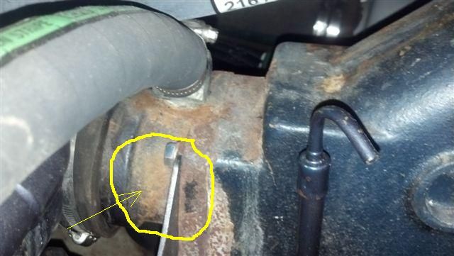

    i've got a leak. Looks like there is a collar on the output side of the riser to the heat exchanger and it is spitting a good amount of water. Appears to have rusted thru. I've done a lot of searching for this particular style of riser but cannot locate. any help and/or can one just find the collar to replace?

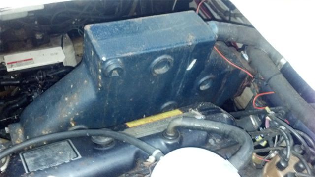

    here is the riser - the area in quetion would be on the right of the pic, where that wire is hanging down.

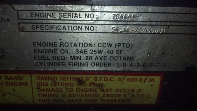

    here is the plate
    here is the collar (this is actually the 'good one' but better picture opportunity

      That appears to be a one piece manifold. If so, you don't actually have a separate riser per se'.
      Rick E. Gresham, Oregon
        yeah rick as i was surfing last night that realization came to me. That and i was too drunk to keep looking so i went to bed.
        so it appears i will be replacing with a different style? Oh well, most of the hoses are in need as well.
        btw they are us marine 454.

                              It only had 150 hours on it when we bought it so my assumption is always ÔÇÿwhat is rottedÔÇÖ rather than ÔÇÿwhat is worn outÔÇÖ. From my vantage point on looking at the leak and blindly feeling the spot it felt like a hole. This weekend I actually got in there and can see that it has been leaking for some time causing rust at the gasket of where the riser part attaches to the collar/nipple that goes to the hose. It felt like a small hole but as I cleared the rust I could see the two parts (and of course the bolts that hold it)
