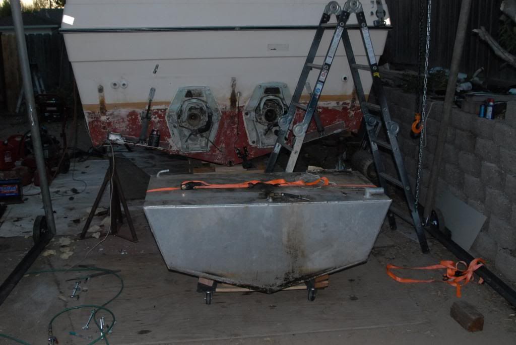

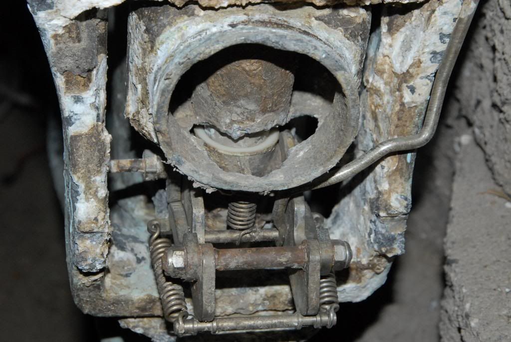

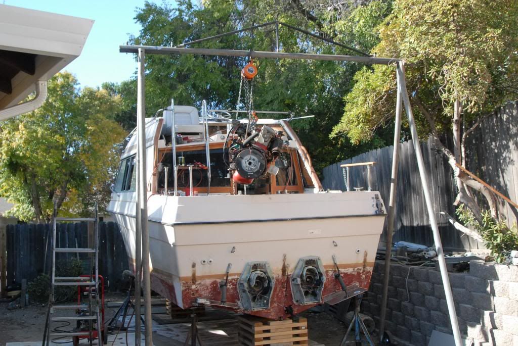

    After a thorough pressure washing I discovered that both drives had been rotted away along with the transom shields. It turns out the reason for the free spinning motor was the props center hub was rotted away and couldn't hold the power.
    So, I had to build an A frame to get both motors out. I'm lucky I had some heavy steel pipe here that worked nicely.
    The starboard shield/bell housing came out ok. Someone had been in it before because there was anti-seize on the bolts. But I had to drill the head of the bolts off to get the port side apart. needless to say this hasn't been fun.
    Oh, and I figured out why the boat didn't steer very well. I was back and forth at slow speeds.

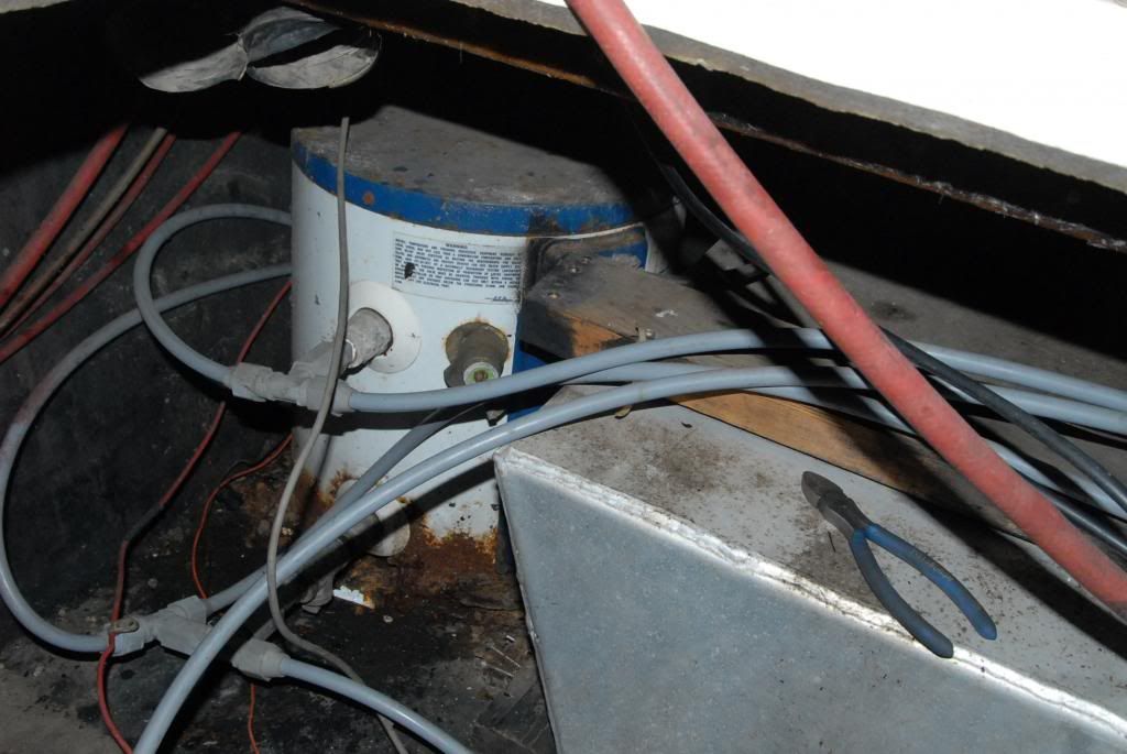

    OK, you get the picture of what I bought. Junk right! That's just the beginning. Motors and shields out, the discovery continued. Pulling the batteries out I found that the extra piece of plywood they were sitting on wasn't anything more than a patch covering the rot under it. The rotted out water heater didn't help matters either.
    So out came the gas tank. Now there's a bright side, I got at least 90 gallons of good gas to use in all my vehicles this winter. Hmmm, it only cost me 4K. :P

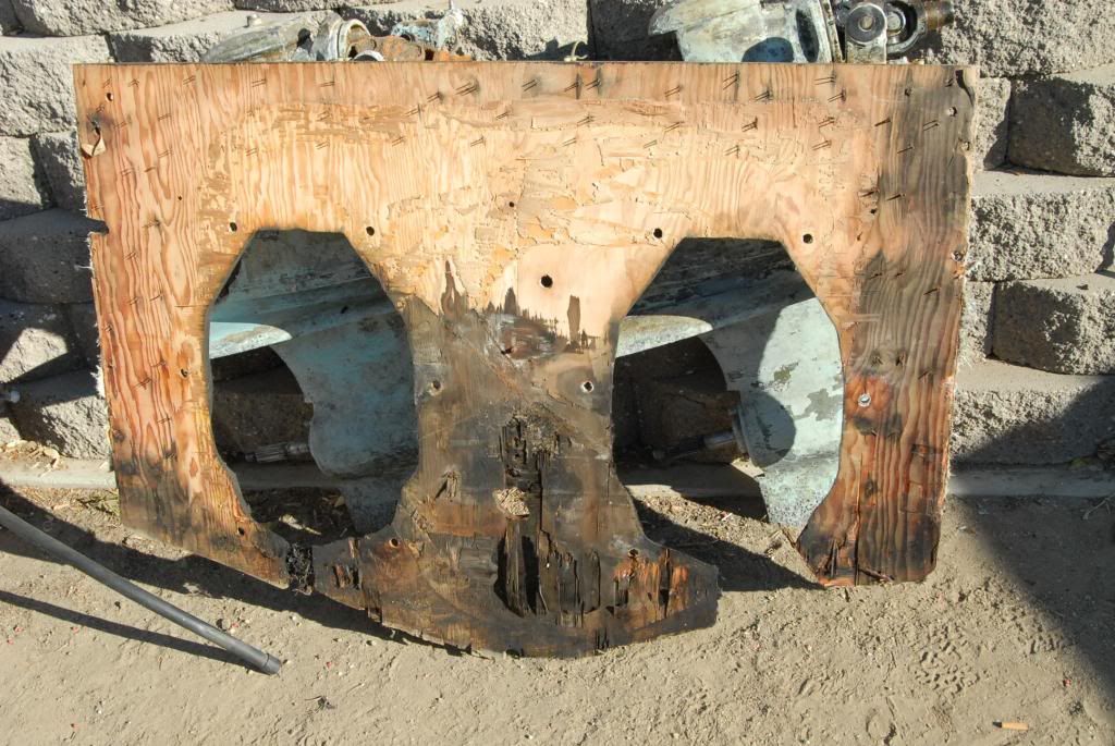

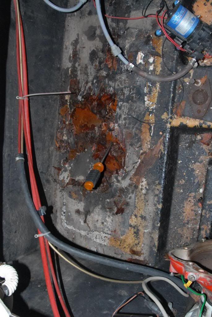

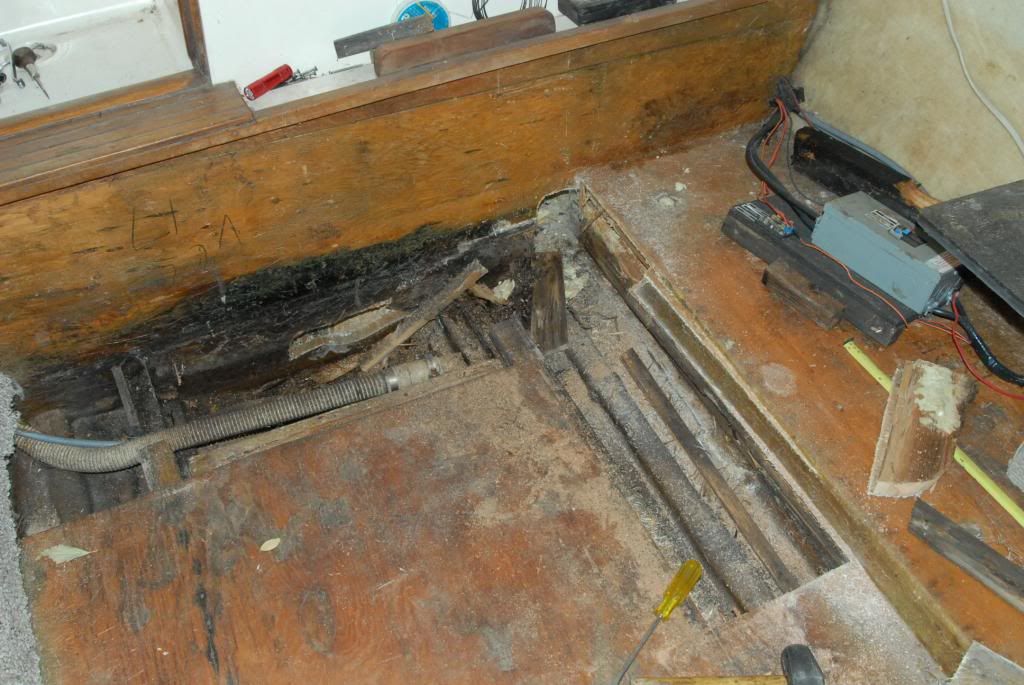

    I'll just cut to where I stopped today before I started this post, just for a break from the depressing site. The dry rot is of coarse in the transom. I pulled one layer of it off by hand after cutting the very thing fiber glass that was around the edge. You gatta love production line work eh...
    To put it mildly, the cancer spread from there along with the stringer, fuel tank pad, bulkhead into the interior, etc... I'm not sure how much farther it's going to extend. But today I realized the interior floor has to be cut out to get the fresh water tank out of the way.
    Bottom line here is that I have a lot of work/money ahead of me. I've asked myself the same question I'm sure your asking. WHY continue? Well, I remember how content and relaxed my boys and are were when we spent a 3 day weekend sitting at the dock fishing and having a good time. And, I've done this kind of work before, just not on a boat this big. Right now it looks pretty depressing. But as soon I get to the end of the rot and actually have things cleaned up and ready to start putting new wood in, things will look and feel better. And when I'm done with what promises to be a long project, I'll have a new boat that I'll be able to depend on.
