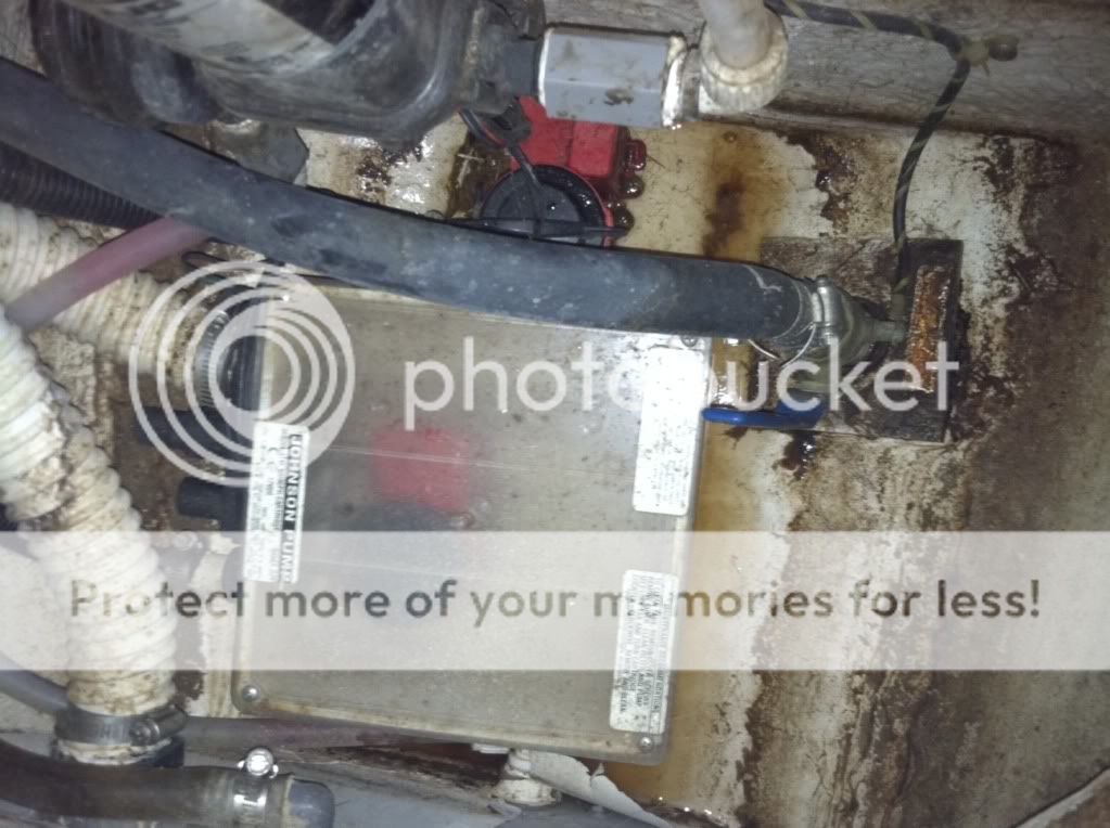

                Looking down under the stairs, this picture below shows my shower sump, the toilet seacock, and at the top of the picture is the fresh water pump. There is a gray coupler on one side, does anyone know if this is a threaded connection? Push lock? How does it work? Its snug by hand when i try to turn it. It also leaks a little bit when i turn the fitting. And would this be the "in" or "out" side? In this picture, the top of the picture is Aft. The bottom of the pic is forward.

                    No, i cant find any valves or bypasses going to or from the water heater. I will try un-hooking the outlet hose from the pump and seeing if it turns on. I am a little nervous about unhooking the hoses from the pump, as i cant tell how they are attached. They look like theyre threaded somehow? But it seems like most of the people talking about them have some sort of a push connector.
                      The grey hex shaped fitting is a simple threaded coupling.
                      The white elbow to the left of the grey coupling appears to be a push in fitting. You push down on the ring / collar and the tubing slides out.
                      Since yours has likely been in a long time push down on the collar and hold it down, then push the tubing in a little and then try pulling it out. You need to keep the collar down until the tubing is out.

                        I assume that is teflon tape used on the threads on the gray coupler. It appears to have a very slow leak where the coupler meets that elbow. Turning the connection by hand made it worse. I will unscrew it here to test my pump issue, and hopefully re-tape and re-connect this fitting without making anything worse!
