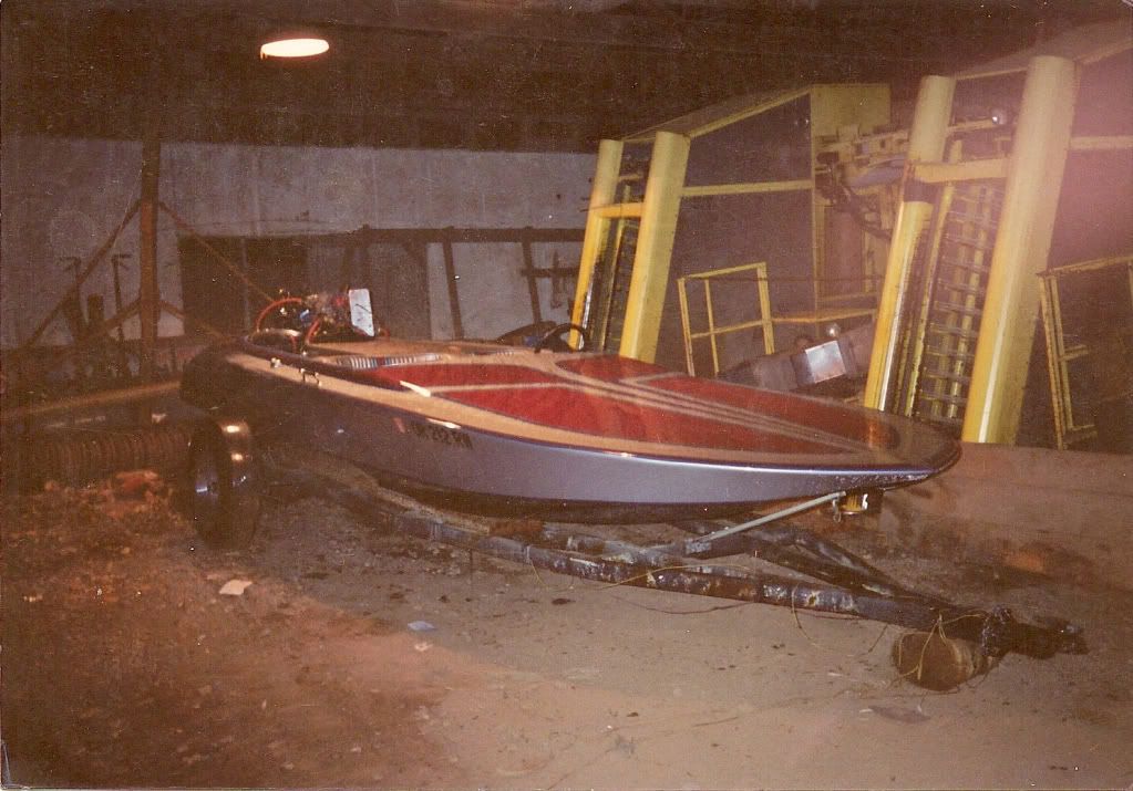

                Now..... if you want to impress your Jet Boat buddies, here's the way to do it.... but you'll need to get your check book out.
                Courtesy of Bill L (aka Billbayliner) .
                http://www.baylinerownersclub.org/fo...lking-on-water

                              If you really want to impress your Jet Boat buddies......
                              a properly built GM SBC ........ + this
                              = this..........
                              And he's probably going faster than any of us would ever want to ski behind.
                              Remove the prop set for skiing, and install a high speed set, and...........................
