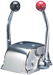

    Here's a Twin S.
    There is no removable cover. Only the little plate that covers the stop adjustments.
