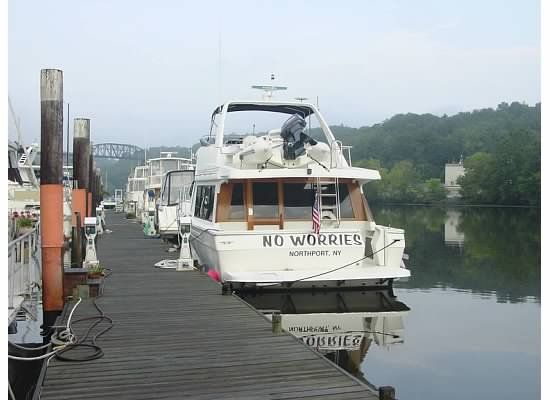

    Hi all I just installed new lock for sliding door. The bigger issue I am having is the operation of the sliding door. The weight of the dinghy above has pushed the door jam out. After talking with John at Banana belt boats. I seen he installed a cable with turn buckle. Took it down into the engine room. That helped him pull in the cockpit wall in. I did the same thing. But door still rubs a lot. There is a wear patch mid span on the door. Lock is tuff to lock. When dinghy is in water. Door fly's open. PO moved the track at base of door out to help door move better. Now nothing is working correctly. Thinking of second cable? Any ideas.

    The dinghy should not be deforming the bridge deck and affecting the door. We used a cradle for the dinghy that spread out the load both fore/aft and pt/stb rather than having any single point loaded highly.
    Additionally - carrying the weight as far forward as possible on the boat deck will also help.
      Yup we have 4 point for dinghy. Forward to where you can barley get around bow. I know its under 750lbs. Talked with mechanic who has seen many 4788. He seen the cable idea as well as metal carried all the way up to upper deck. So I just figured it was a common problem. I am just lucky that way.

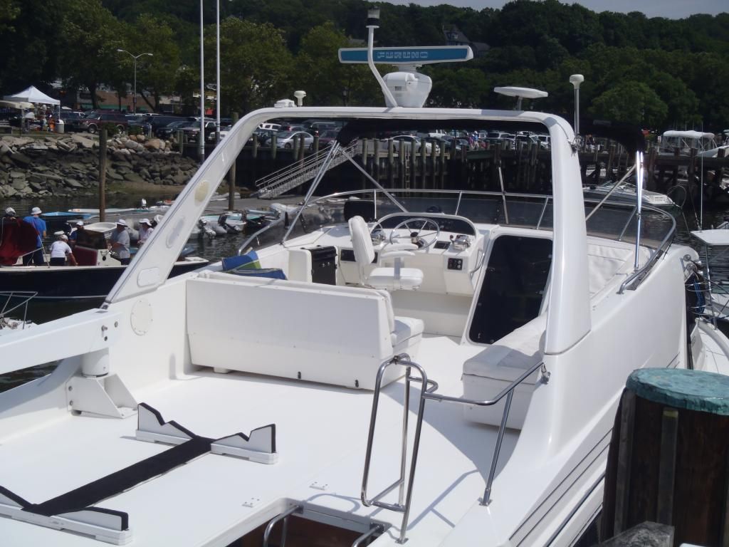

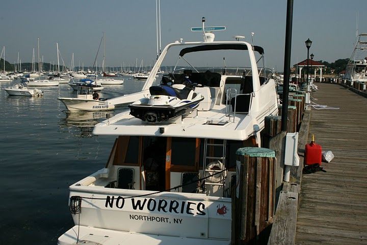

        1995 4788 , no deflection of upper deck or door issues with carrying toys, this RIB is likely heavier then on your deck....
        This jet ski is about 100#'s heavier then the RIB above.....
        This is the cradle that they rest in...
