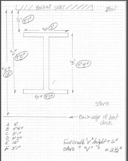

      We made a cradle out of Alaskan cedar epoxied white that carries a 12.5 zodiac or a couple of versions of jet skis (kawasaki 12-f).
      here is a sketch of the cradle and some pics...

          Yes Ron...that's exactly what I'm looking for I think This might be a dumb question but was the cradle bolted down to the floor or did it just float so you could pick up and move when the toys are off? I don't particularly need height per say as I can raise the motor up. I just need it to sit right down into something like this! Thank you

            "This might be a dumb question but was the cradle bolted down to the floor or did it just float so you could pick up and move when the toys are off? I don't particularly need height per say as I can raise the motor up. I just need it to sit right down into something like this! Thank you"
            Hello Derek,
            If you look closely at the pics the entire cradle sits on 1" starboard that holds the wood off the deck and allows water to drain- they are large to spread the weight around and not overload the overhang. At each outer corner there is a 1/4" SS bolt that goes into a 'well' hole where an expandable well nut goes. I think they were the same ones they use to mount the fly-bridge seats when there is no access to the backside. When I placed the cradle down I caulked it in with 4200 at each pad as well as each bolt. The cradle was on the boat for over 8 years with no issues and serviced 2 RIBS and 2 Jet skis during that time with the cutouts we used. I used 2 SS ratchet straps fwd and two to the stern to hold the dinghy/ski in place.
