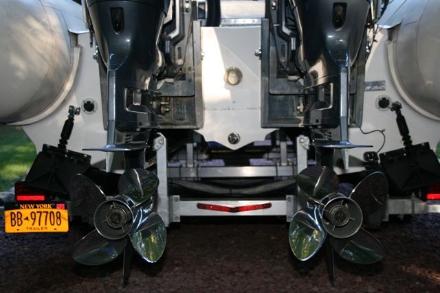

    I do know about cupping as it relates to higher speeds and a couple of my past 'dinghies'....
    Here are a couple of 'partly' cupped props on my last higher speed RIB....
