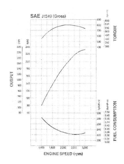

                            Maybe I have the fuel/hp curve around here somewhere I can post back.....
                              WO6-D -TI-II Hp/fuel curve
