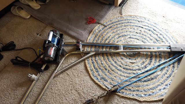

I added a 45 degree tube at the bend to stiffen the arms. They were rated at 300 pounds and I needed 380.
also added the winches as I am too old to pull a block and tackle if I can avoid it. fail rate was 600 pounds before the mods and at the bend to the right of the winch
so lots of safety factor.
