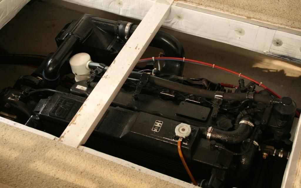

                    Here is a picture showing the extra oil "puke" can added before the air cleaner to help capture some of the blowby before fouling the air cleaner and intercooler, it is a white PVC item added immediately before the K & N air filters ....
