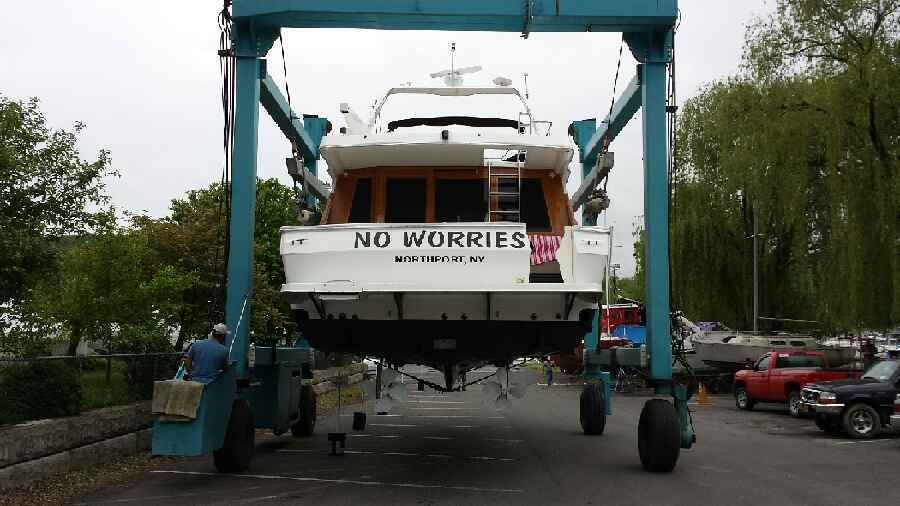

                  These pics might give you a start ....
                    Norton Rider has the answer above to be sure. Our 47 (same hull width as 45) fits nicely in a 15' slip. I have fenders mounted horizontally on the dock. We can slide right in with about a foot and a bit on each side. I'm in a very protected marina. There are also companies that make rectangular fender type material that mounts to dock. They look to be only 3-5" thick which will give you more space.
