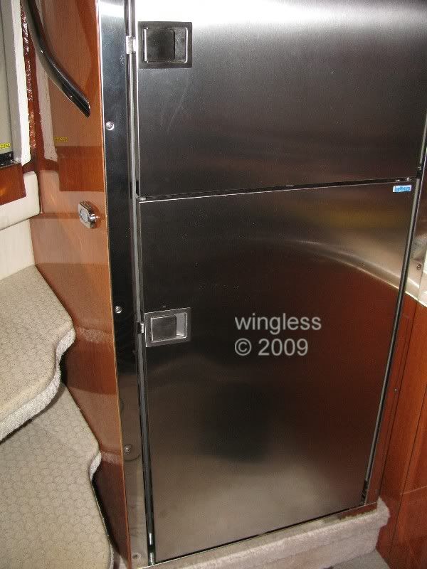

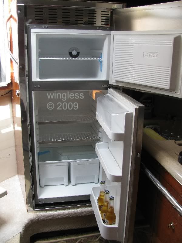

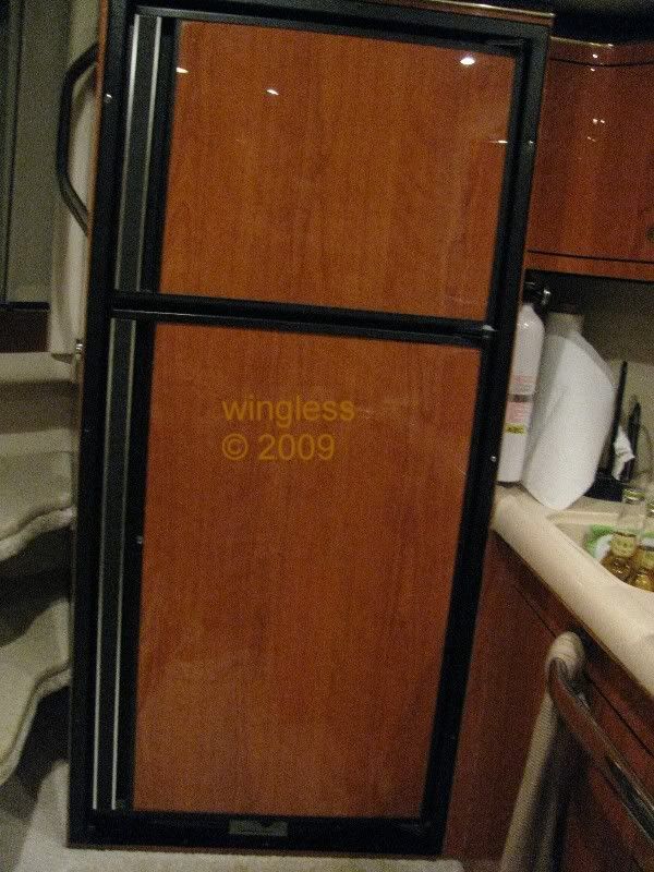

        It does sound like the AD/DC power supply that is integrated into the Nocold 'fridge has died. My Nocold DE-0061 also died.
        The replacement I installed is an Isotherm CR187. It is a superior appliance w/ the all-important Danfoss compressor. This model also has a great forced air coil cooling system, that sucks air in on either side of the 'fridge door and expells the warm air out the top, concealed by the freezer door. It can be installed into a closed compartment, not requiring rear air flow.
          Thatsa lot of fridge for only three beers!
            +1, but at least they are Corona!
              Please provide me a break. It was the power-up test...
                Sweet looking fridge, that stainless looks all professional and stuff.
