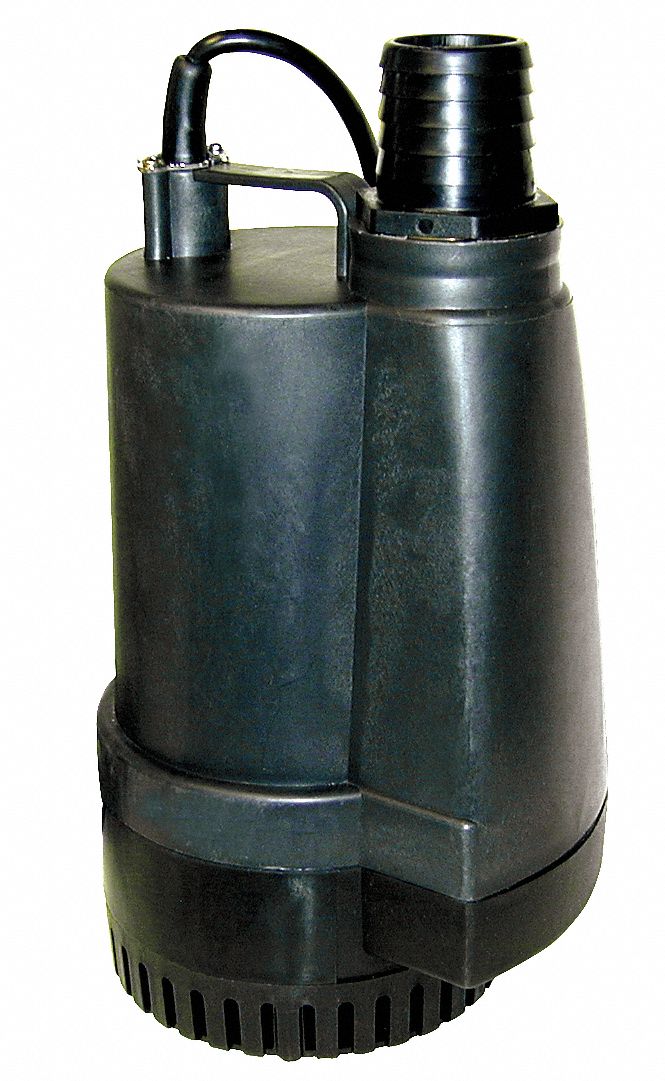

    Has anybody installed a high capacity dewatering pump on your boat.
    On the 4788 there are three pairs of sump pumps. If there were a major issue these pumps of course do not have the capacity to keep up.
    I'm considering adding a AC powered large capacity dewatering pump. Something with a 1.5 or 2" discharge.
    Something like this
    Looking for ZOELLER, 110V AC, Plug-In Utility Pump? Find it at Grainger.comĀ®. With over 1.6M products and 24/7 customer service we have supplies and solutions for every industry.
    Has anybody installed anything like this?
    Has anybody ever heard of an actual situation where a boat could have been saved if they had a pump of this large capacity?

    Wondering why AC. Would you plan on inverter power? Several folks I know have a small gasoline powered pump on board with some large diam hose for extreme emergencies. Of course an AC pump can be started via float switch so if you are not aboard, it might save the boat.

          I'm thinking AC because a 5 amp AC pump is equal to a 50 amp DC pump, a 15 amp AC pump is equal to a 150 amp DC pump. Wiring is easier, and there are lots of high capacity AC models available to choose from. I also have a nice large inverter thats out of the "flood zone" IE it is higher than the top of my house bank.

          Speedy deployment is also a consideration. If I have an electric pump, and have an issue all I have to do is flip on a breaker in the panel and we're dewatering. A gas pump would require probably a few precious minutes minimum. Minutes you could better spend on trying to stop the source of intrusion, or calling for help, or even deploying the liferaft. Even if an electric pump would eventually be overcome, it would probably buy you escape time. That time could be critical to your or your families survival.

              I wouldn't go AC for the stated reasons. Also, the capacity of that pump is relatively low and only gets worse with greater head. Why not use the USCG P6 pump? Gas powered, plenty of output and relatively compact. Then you'd have an emergency pump independent of your ships' systems with enough capacity to really help you out.
              Max 276 GPM, lightweight, small...
