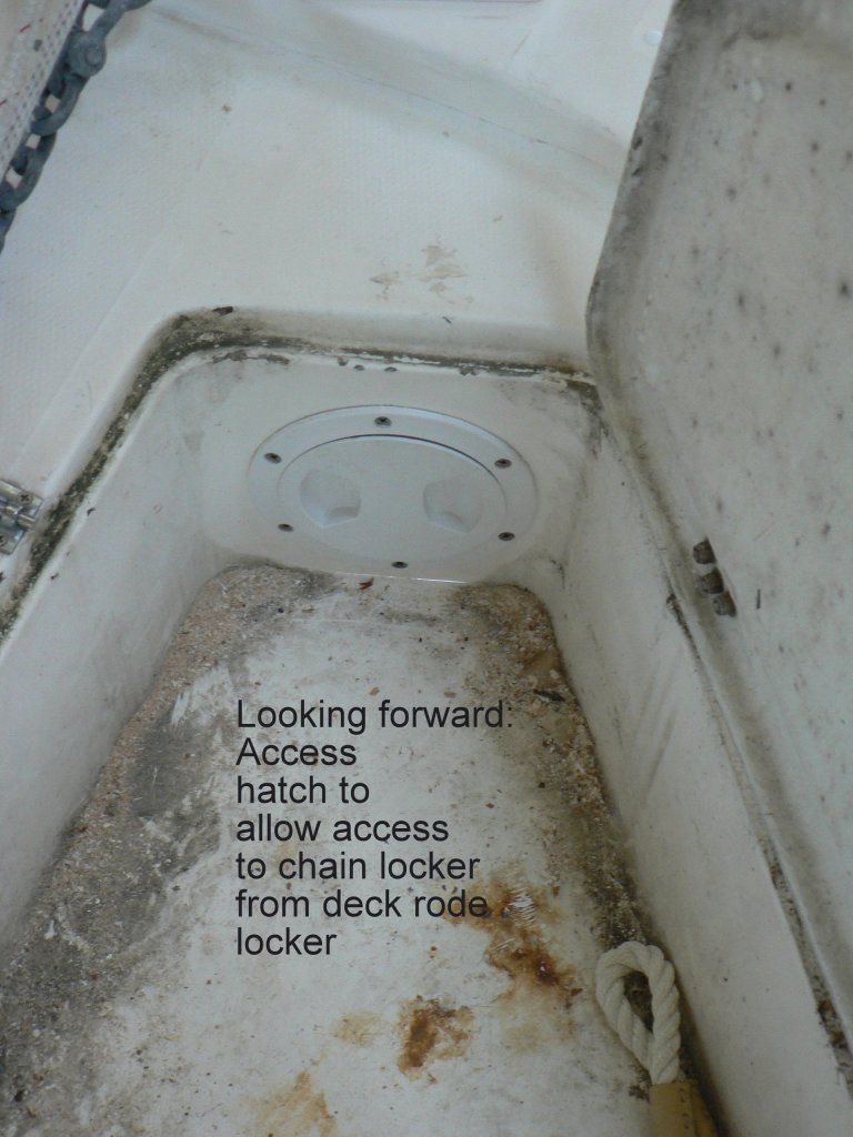

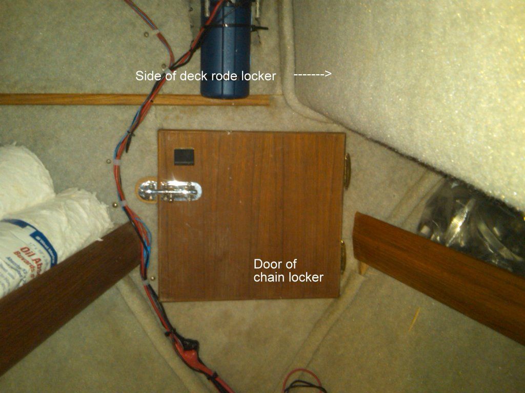

                      I have never looked carefully at a boat without a windlass, so not sure what actually came from the factory. There is a locker formed in the very bow of the boat, in the front of the vee berth, and it's formed by the port and starboard sides of the hull at the bow and the aft vertical section is made up by the small bulkhead at the front of the vee berth. This is directly under the windlass as mentioned. The aft bulkhead typically has a wooden door cut into it to allow you to access the rode from the vee berth to clean the compartment because the drain hole is small and the debris accumulates, make the connection of the rode to the hull, and flake the chain as it piles up and finally stops the windlass from operating. I have 205 ft of BBB 1/4" and this occurs on mine.
                      From the factory, the standard anchor rode locker on the deck does not connect to the compartment mentioned above. A common modification is to drill a 4" hole in the very front vertical wall of the deck anchor rode locker and install an access plate, thus joining the two compartments. Then when you're bringing in the chain/rope, you can reach into the forward compartment FROM THE DECK, and flake the chain to either side. This avoids having to have someone down below do this, or your having to run down to move the pyramid formed to each side and make more space. I've made this modification and for the $12 for the access plate along with the risk of ripping your arms off with the 4" holesaw bites through, it's well worth it.

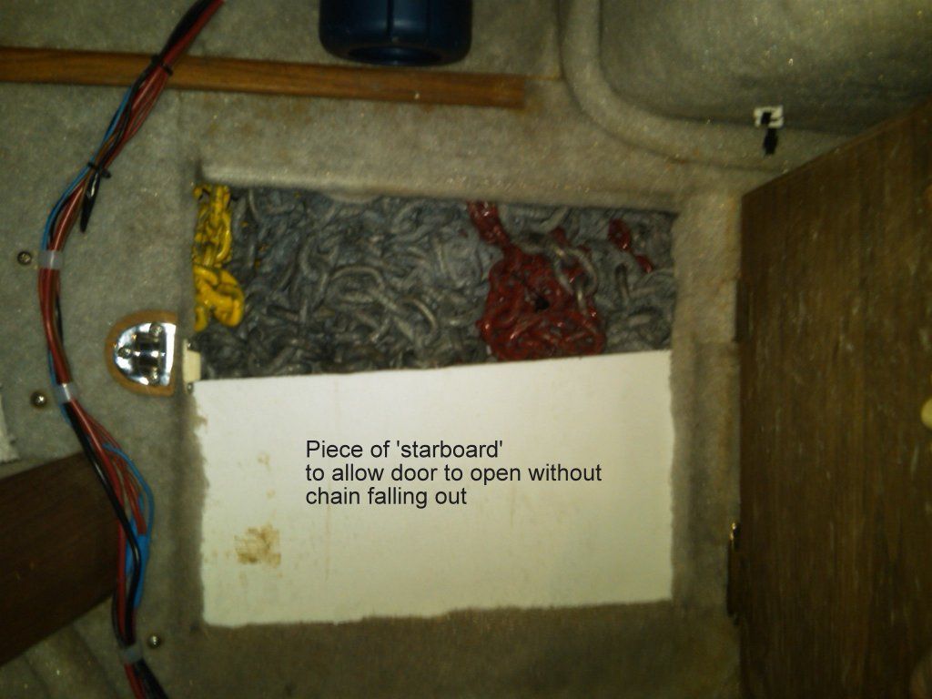

                      So what happens when you open the bulkhead door from the vee berth to flake the rode and there is already 80% of the rode in there? It wants to fall out into the vee berth on your nice cushion, if so equipped. So the other common modification is to put a piece of wood or clear plastic inside the locker, across the inside of the doorway, but it does not go completely to the top of the opening which the door covers, so you can reach past it to again flake the rode if needed. So this piece covers 75% of the opening created by the doorway. And yes, pictures would be better and I'll post pictures later today if I remember (a true challenge).
