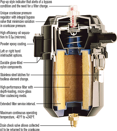

                    I ditched my Walker Air seps in favor of the Racor closed crankcase ventilation system.
                    My blowby now goes into a Racor CCV 4500 filter cannister and then to a Racor Air filter.
                    The CCV 4500 collcts the oil in the blowby and either sends it back tothe crankcase or to a puke bottle.
                    I used to get some sooting of the transom and now I get none at all.
                    My engine room is clean and there is no diesel smell at all.
                    Very happy I made the upgrade.
                    the air filter is much quieter than the walker air sep, you can see the hose barb that goes to the CCV 4500 just before the turbo connection.
