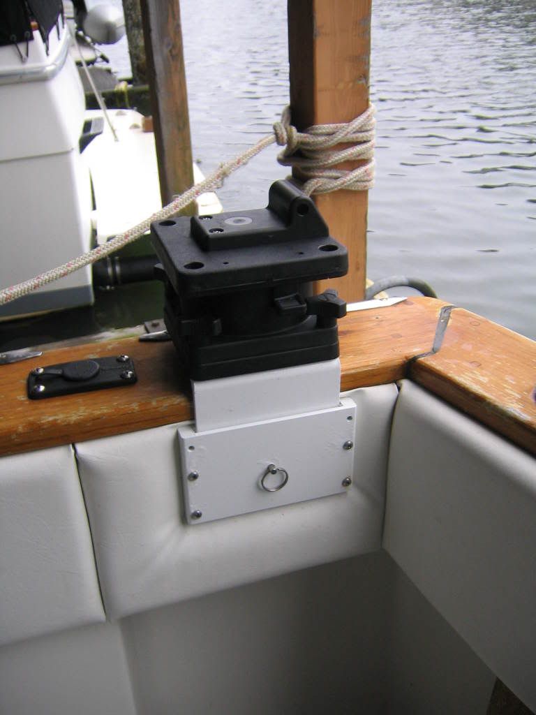

          Brad had the name right, they're called Offshore mounts. I bought mine at Harbor Marine in Everett. Here's how I had them mounted on my 3288. Since I had a little higher installation, I installed the center pin for a little added security that it wouldn't come out.

            That's it Cosmo, I think they have a clean look and ya don't have to mount the more bulky type down rigger mounts.
              Yikes ... no offence but if you ever hooked a ball on the bottom that thing is GONE along with the DR
                I have them in my Scout They work great. I had a fear, like you, that they would come out but gravity and friction keeps them where they belong
                  The pin goes thru both pieces of the offshore mount, including both sides of the mounted "pocket".
                  It keeps it pinned in place so it can't come out. It would need to sheer the stainless pin before it would ever come out.

                          Looking at the mount in the photo, IF the vertical mount is through bolted to solid fiberglass it should work perfect. Most all the forces are fore and aft with a bit side to side, nothing pulling up, and if it did it would bind even if the pin broke.
                            I have hooked a ball several times with mine and they just wege in tighter. After trying to saw my boat in half with the cable in strong current and the ball firmly stuck I now alwasy haves a cable cutter handy. As you can see I also had my concerns there is a safety line attached to my DR
