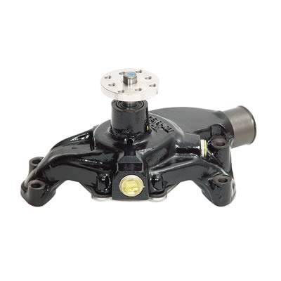

      It's open cooling system... I ended up with this pump...
      Free Shipping - Mallory Marine 9-42606 with qualifying orders of $99. Shop Water Pumps, Mechanical at Summit Racing.
      And... They matched the price for the one I found on Amazon!

        Looks good to me!
