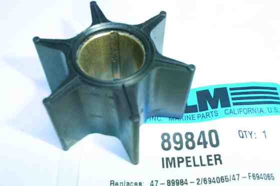

                      Sarah, this is what your A drive impeller looks like.
                      The vanes on the A drive impeller are short and rather stiff compared to many others.
                      (examply image only)
                      Here is a more coventional style impeller shown in a pump body that uses a cam to flex and fold the vanes over.
                      Your A drive impeller vanes fold similarly, but instead of the cam folding them....., the pump body is eccentrically positioned around the shaft (no cam).
                      A very similar fold occurs, and is what causes the "set" during prolonged non-use.
                      IMO, the A drive impeller is more prone to taking this set than many other style impellers.
                      What this means to me, is that of all the different style impellers, this one is best if at least inspected more frequently.
                      The "set" that these will take occurs more so from "non-use" than actual use.
                      This also means that you should not let anyone talk you into a new impeller during lay-up. That is a lousy time to be installing a new impeller only to let it sit at rest within the pump body with three or four vanes folded over.
                      Instead, put this on your re-commissioning list, and begin your season with a fresh impeller.
                      Keeping a spare on board (as the guys have said) is great, but will only help you if you have a way to pull the boat out of the water.
