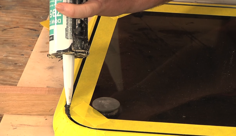

                Here's a decent video on a similar repair. You can have a new lense cut using the old as a template.
                This project was a true test of patience! Duct tape… Baked on duct tape…. To remove the adhesive I used Naptha VM&P (which is safe to use on most polycarbonates). The black caulking was Dow…
