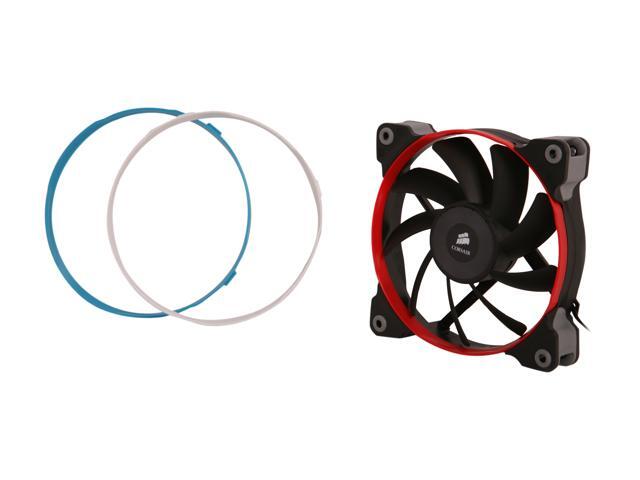

      There are a ton of options for 12v fans to help with cooling the dash or the water proof box for the stereo. here is a low noise option at 120mm. there are 80mm options as well.
      Buy Corsair Air Series AF120 120mm Quiet Edition High Airflow Case Fan Single Pack(CO-9050001-WW) with fast shipping and top-rated customer service. Once you know, you Newegg!
