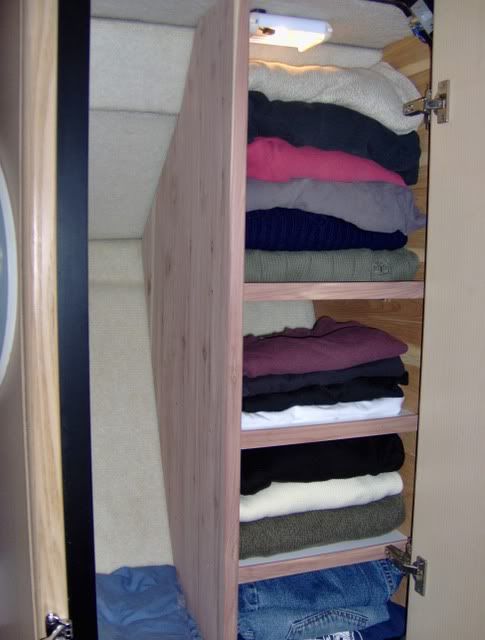

      I have two large hanging lockers in the master stateroom and only six clothing drawers under the master berth.
      And one even larger hanging locker in the spare stateroom.
      I made up a set of shelves for one locker using 2/3 of the available space using cedar with laminate on the upper surface.
      Nice storage for sweaters and polos. I cut down the closet rod and reinstalled it in the other third so I can hang a wool suit
      and several other items I don't use often but don't ant crowded in with everything else in the other two lockers.
