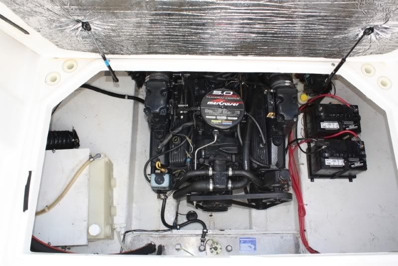

                All the heat exchange units I looked at where not recommended for salt water once I got to read the manuals.I have not fitted this unit to the boat as yet[my new to me one is still in Florida] so I'm all ears for better ideas .We do go out to some islands and stay a few days at a time diving etc so I won't always be running the boat hence I thought of using a generator an hour a day to top up batteries ,heat the water and let the cook use whatever she deems a necessity .This worked for off road camping etc so I thought I do the same with the boat.
                The engine cooling is a raw water set up in a 2355 ciera 5ltr poverty pack LOL.
                The unit won't go to waste as I own a caravan park so I can use it else where so all ideas are appreciated.
                Thanks Dave
                  If you are gonna run your engine in salt water raw water cooled, a $400 water heater is the least of your worries!
                    is this what I need to start with?
                    Buy Mercruiser Closed Cooling System - 1997-2001 Small V8 Carbureted w/ Serpentine Belt & High Port Side Mounted P.S. (#MC321) (#MC321) from PerfProTech.com. Online Shopping for Mercruiser Small V8 Closed Cooling and Fresh Water Cooling Systems at PPT. We offer both High Capacity Full Flow Systems as well as Standard Capacity Tube & Shell Designed Heat Exchangers.
                      I would say that or something similar. What is the water temp where you will be boating? That will have a lot to do with the size nd type heat exchanger you need.
                      The ones that work extremely well in the Pacific Northwest seem to be marginal in Florida for example.
                      I'm assuming the boat has never been run in the salt?
                      I've been told that if it has there is no point in converting because of something I didn't understand
