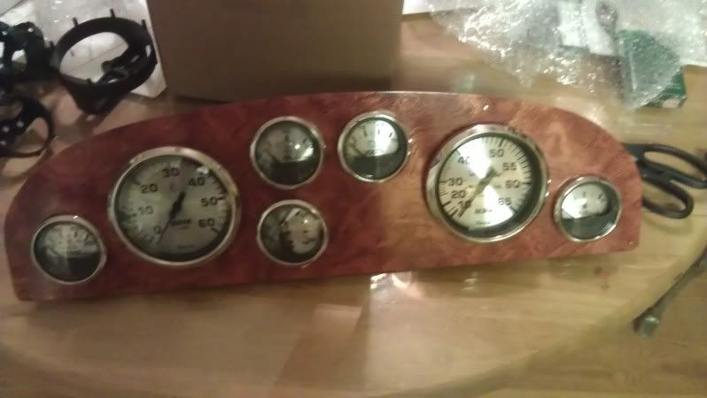

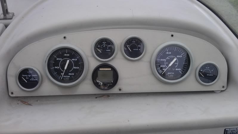

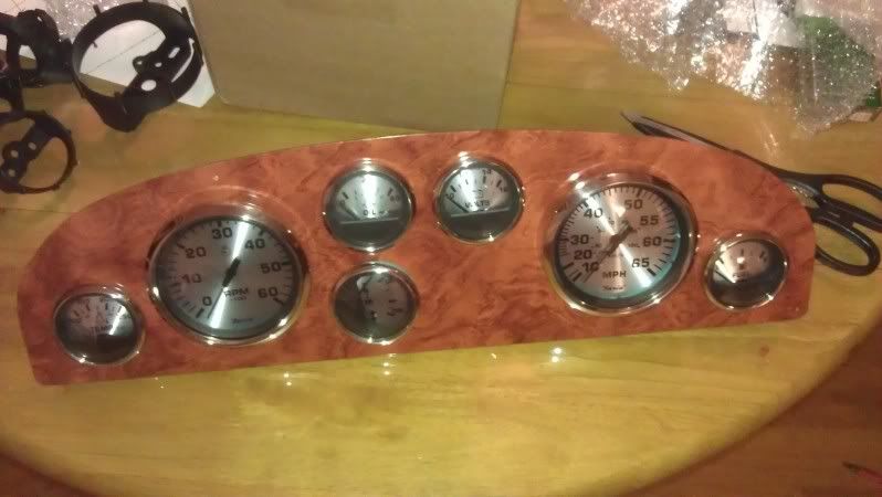

    Pulled my original 95' gauge cluster out and replaced them with some new Faria silver spun gauges and 3M bubinga wood laminate sticker for backing.
    Before . . .
    and
    After . . .
    That looks sharp! Nice choices.

        Looks great! I'm looking to do this on my 1995 2655 also. Did these gauges come in a set or did you buy them individually to match the cutout size of previous gauges?
          They come in a kit. Alot cheaper to buy them as a kit unless you just need 1.

              Where did you get the laminate?
                ebay . . .It's 3M Bubinga

                  Is it the self stick laminate? If so, did it adhere well to the old panel?
                    Yes, it is self stick . . .It adhered really well, but I also made sure I cleaned the old surface well with bleach then alcohol.
