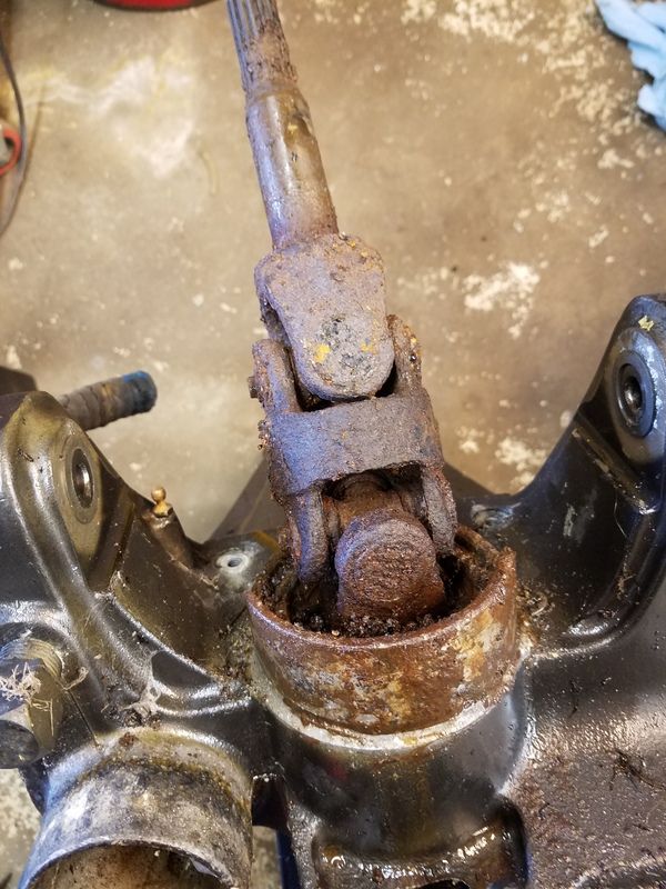

    And found the problem.
    The driveshaft ujoints are toast, so is the support bearing.

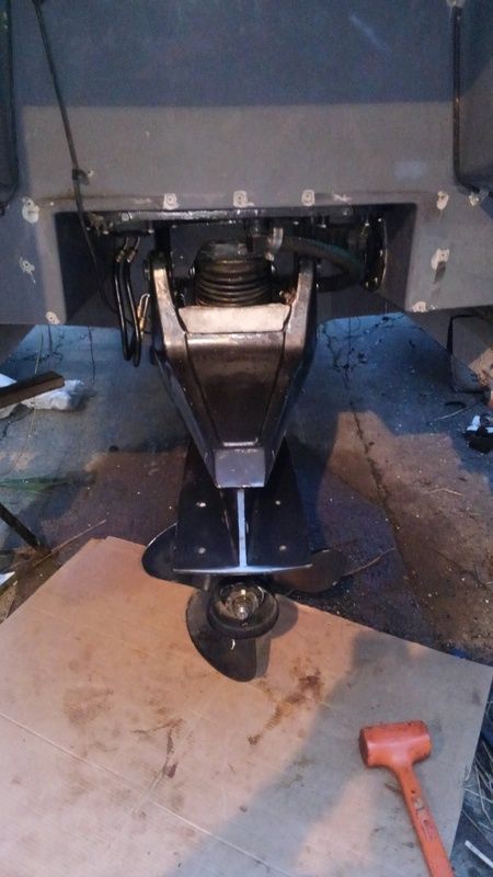

    Then stuck it all back together
    Currently, I need the exhaust bellows hose, a trim motor if I can't salvage the old one, then mostly odds n ends, blower, hoses and such. Maybe some upholstery.
