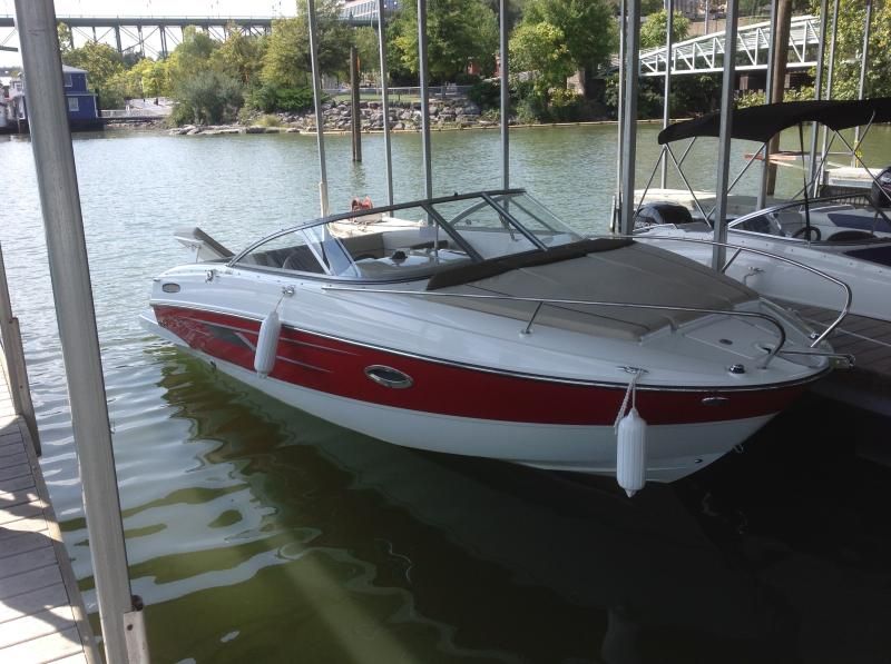

    I drove a boat with a new 4.5L V6, a Bayliner 215 Deckboat. I was able to directly compare it to the blue Bayliner 195 Deckboat immediately behind it, running the hoary old 4.3:
    Additionally, I also ran a 642 Overnighter cuddy with a 220 hp 4.3 as well....
    ...so I had a good baseline of old vs. new.
    Now, I grant you that I was comparing separate boats, but I have run enough 4.3s to be a pretty good judge of improvements. The 4.3 is a good engine in terms of it is cheap to buy, cheap to run, parts are ubiquitous, they are easy to fix, and they are pretty bulletproof on the reliability front. The demerits are many, and I spoke to them above - its very unrefined, it feels old, it sounds old, it's thirsty for being small-displacement, it doesn't produce as much hp as it should, and it is a dirty engine.

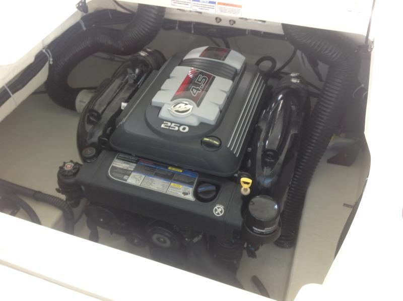

    The engine is a clean and compact installation in the 215. I particularly appreciated major maintenance information clearly placed on a placard right on the front, clearly visible. No more digging for a manual for basic information like maximum RPM. Other maintenance points like power steering and oil filter are directly up front where they are within easy reach:
    Jump in the new 215 with the 4.5 and you will notice the difference right away. First thing you notice is the noise, vibration, and harshness issue. The 4.5 is smooth and refined sounding when you start it up. By comparison, the 4.3 jerks and vibrates to life and does not sound like a V6. Performance was also an eye opener. The 4.5 is slightly lighter than the 4.3, and nearly an entire person lighter than the 5.0 V8. In the 215, this resulted in very little bowrise and excellent acceleration, with a minimum planing speed around 2,800 RPM. This is very handy in rougher waters as well as for towing sports. A 5.0L V8 would still be under the planing threshold at the speed in which the 4.5 is on plane. Stretch the 4.5 out to the 5200 RPM redline and the engine remains smooth, composed, and powerful across the entire power band.
